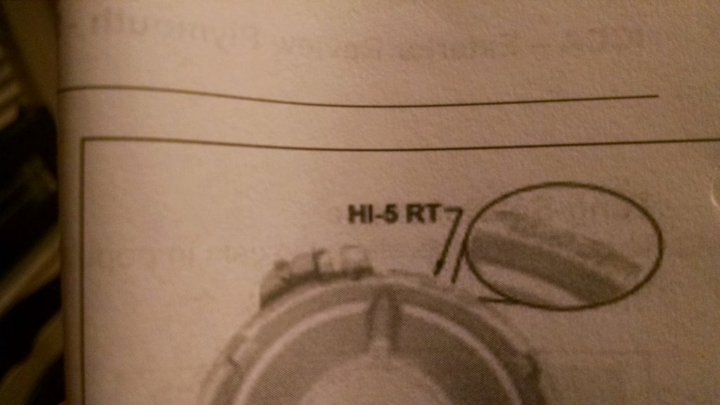

Any one have pictures or a schematic breakdown picture of the headlight buckets and the bucket holder insulation. Trying to put them together first how do you know right from left ?? 70 GTX
Thanks
2 high 2 low and they have a faint stamping on one outside edge......That designates position. Originally on the line each one had a color stripe on the back so they could be placed in the right spot.
The way I figured it out was to get the bulbs as the high and low have different tabs so they only fit one way in the bucket. Mine had 3 different color markes on the back but there is zero info about what each means.
On a 69 there is four color stripes starting from the passenger side to driver side. Black, Blue, Orange, Red...It was for placement purposes....
My problem is the colors are long gone. Need a picture of the location of the buckets in there housing .
