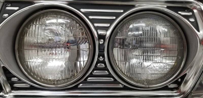

All 4 of mine are GE has well. Whether they are the originals I don't know. Looks like 1/8" fluting on low beams & 1/4" on high beams.
My driver's side low beam is brighter than passenger..I guess its about to burn out.

The narrow flutes didn't come along til around 1974, when improved versions of the type 4000 (37.5/60w high/low) sealed beam replaced the first-generation 4000, which in turn replaced the previous 4002 (37.5/50w high/low) unit, so your narrow-flute lamps are later replacements.
Chrysler's headlamp purchasing in that timeframe was 50% GE, 25% Westinghouse, 25% Tung-Sol. There's some fairly accurate info here, and reasonably accurate, overwhelmingly detailed info here (PDF).
