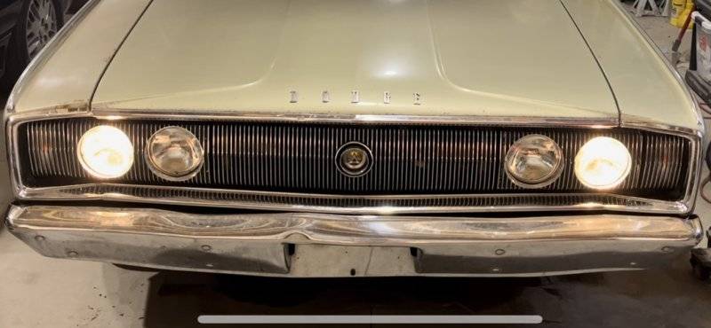

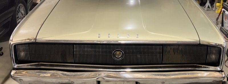

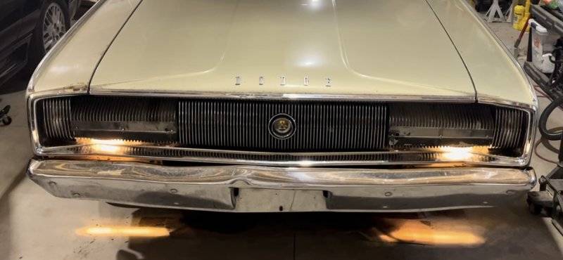

Finally took some time to get the headlights looked at closer other than with multimeter. Which didn’t lie, wiring, switches and relays all seemed to be working fine. I did have to modify one limit switch a touch. The button was worn down some and not exposed enough to allow the headlight bumper to compress it. Testing with finger proved it was still operational. So I bent the stop in on the switch just a touch to allow it to compress enough. I’m guessing this was the reason the PO unhooked everything. I’ll have to keep an eye out for another limit switch to have on the ready. Motors from sitting were a bit dirty, spent some time with steal wool some qtips and the air compressor and got them cleaned out well and spinning pretty fast. The “gear” drive in motor was not what I was expecting, neat little set up in there once I started realizing how it worked. But am glad to say we have operational headlights again, drivers side is a little slower than passenger but not bad. Need to clean up the closed side of light a bit more the paint between fins has some haze.
