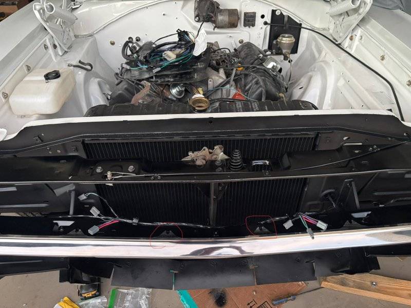

I am in the process of finishing up the front end of my 66. I purchased a new harness and looking for proper routing of the headlight harness before I install the lower rail and grill headlights ect. Thanks

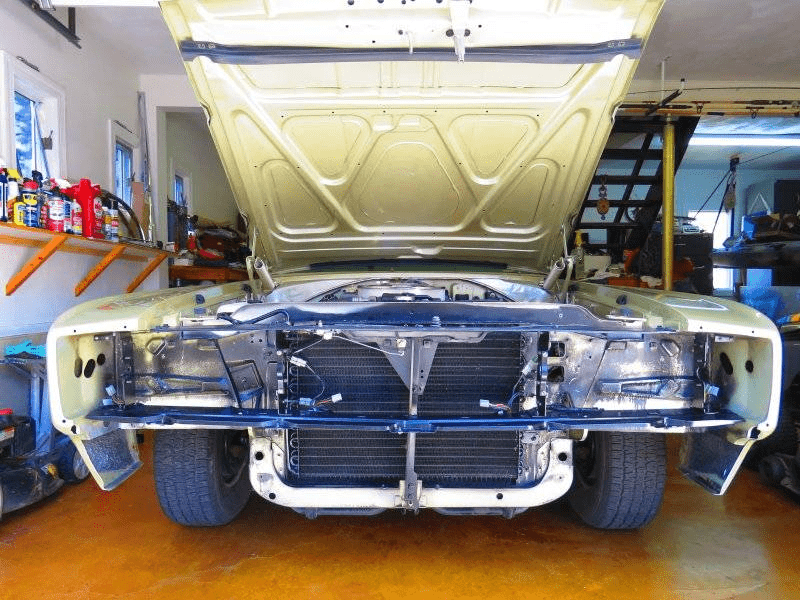

See the black splash shield that runs across the entire lower front? The wiring harness attaches to that black shield. The harness connects to a connector just in front of the battery then through the radiator frame.
See the black splash shield that runs across the entire lower front? The wiring harness attaches to that black shield. The harness connects to a connector just in front of the battery then through the radiator frame. View attachment 1893021
Look about right ? Do you know what hardware is used in the top side of the stainless lower valance circled in red ?
