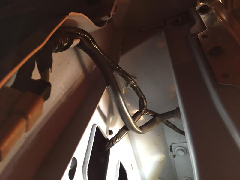

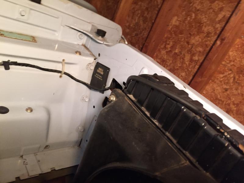

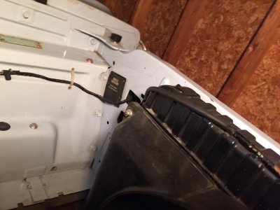

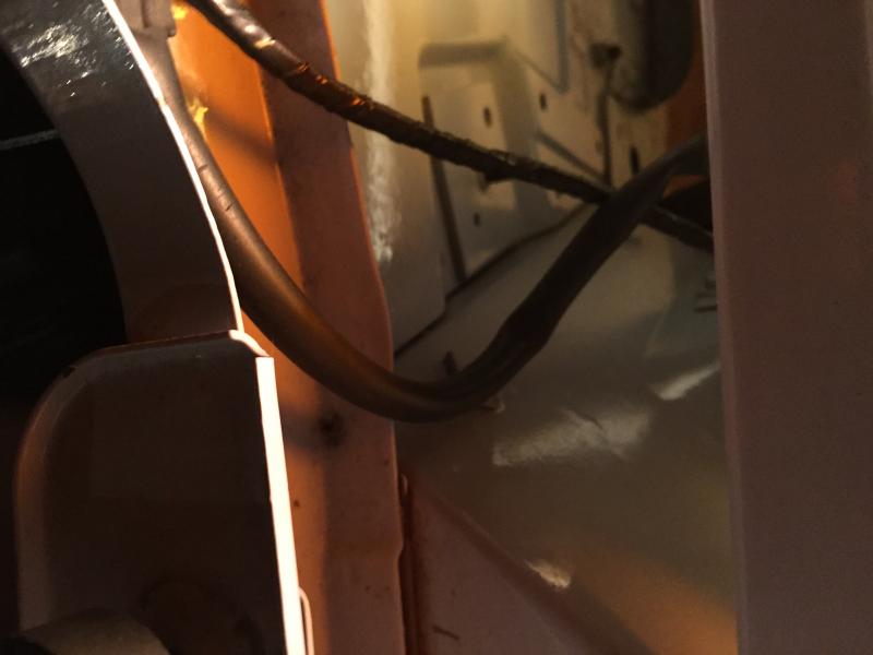

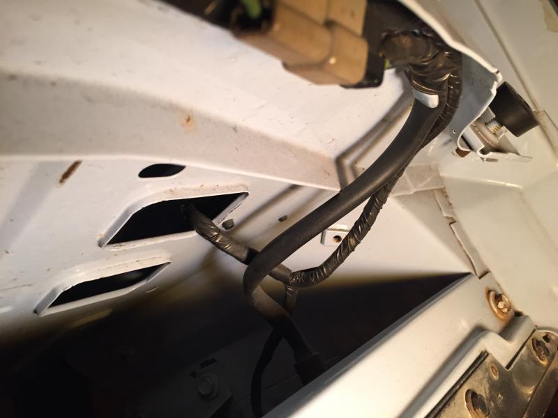

I just stripped and repainted the engine bay of my 66 Satty in preparation of a new engine install. I pulled the wiring and am now confused how the wires are routed for the headlights. There is no hole in the rear of the headlight housing so the wires are obviously routed from the side of the headlight housing.
I'm looking for a picture for reference. If you have a 66/67 Satellite or GTX with, could you take a picture of the wiring from the front of the engine bay/rad support to the headlight.

I don't know how "correct" this is, but here are some pics. The smooth wrapped wiring goes right into the back of the headlight housing and the taped wiring is grounded to the radiator support
Thank you Claw those pics are a great help and reminder, I couldn't remember how those wires were routed. Funny coincidence I used to tease my grandsons, calling myself the Claw and tickling them with claw-like hands.
