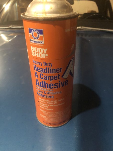

I’m not exactly sure about the sail panels for a 74, but my 70 had a couple slide in clips that you pushed the sail panels over, and one screw per side that held them from sliding back off. I use the permatex headliner adhesive.

Thank you! All of the glass is out and the interior is gutted right now.
