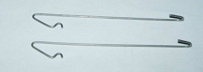

Does anyone have a photo of these two wire/clips that are supposed to keep tension
on the last headliner bow? I see them for sale, but for the life of me I can't seem to
remember where they go??? Thanks Guys!
There is a photo on a HotRod tutorial that show them in the holes of the roof of a '71 Road Runner. However, word has it that in such photo they are in the correct holes, but not inserted correctly. If you notice on one end they have a very peculiar shape for a reason, that being there is a trick to installing them correctly (and I don't know how they are supposed to go or I would send off a photo myself). I am installing my headliner next month, so I will be following the thread. I hope this helps get things started.

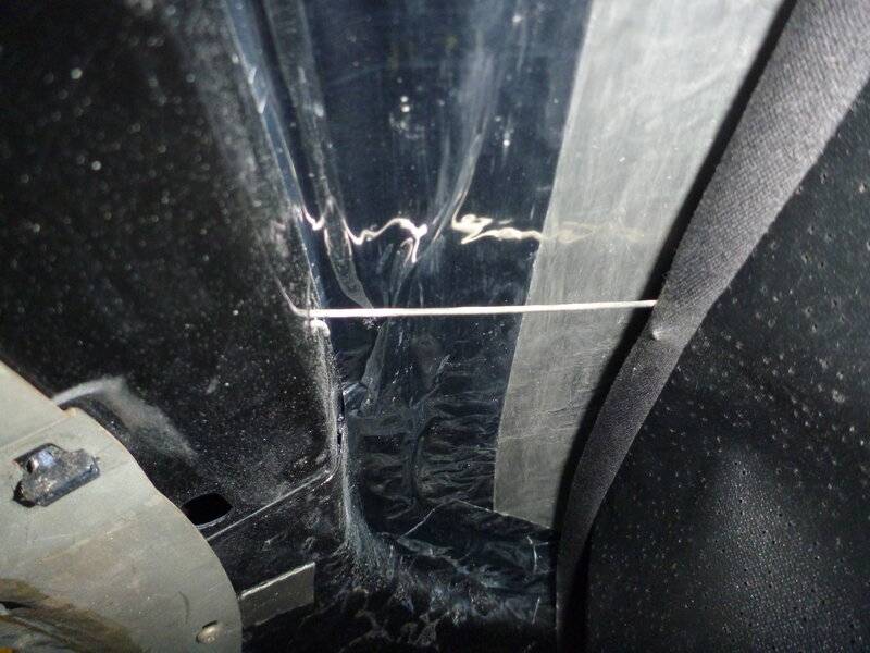

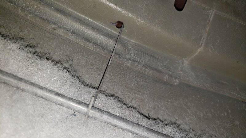

I don't have a photo but have have used them on my 70 charger. The 2 single loop end grabs the final bow and the other ends clip into 2 slots that are present in the metal cross piece above the rear window. Hope this helps.

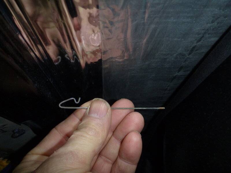

Can you take a pic next to a scale so I can bend my own?? Thanx!
Ha! The pic's help! I have a roll of stainless/inconel welding wire and I think I can bend some up. Really stiff stuff.

So I go out to the Garage today and start looking around to see where the holes are in the last reinforcement
where these clips go and SHAZAM! They're in the holes and hooked up to the last Bow.
