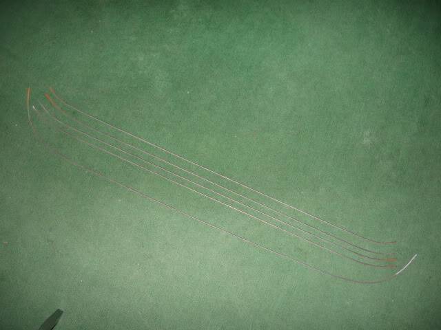

I have 5 loose bows that came with my project 65 car. Anybody know what order they go in?
Assume the top bow in the picture 1, and the bottom bow is 5, what would be the correct order from front to back in the car?
That's a tough one. Four of them look very similar from the pic. The only one I can tell you is the longer one with the big curve goes in the far back.
If I remember correctly, bows 2, 3, and 4 are the same. So If you know for sure which is #1, then you got it made.

Found this hope this will help.
Jeff
1965 2DRHT
> Belvedere. The lengths are front to back: #1= 49 3/4" w/ pink paint
> on end #2= 50 3/4" w/ pink paint on end #3= 51
> 3/4" w/ blue paint on end #4= 52 1/4" w/ pink paint on
> end #5= 54 3/4" w/ pink paint on end and 90 degree
Now that's something that I didn't know, thanks!
I measured the bows and the dimensions work. I also found remnants of the pink and blue paint.
