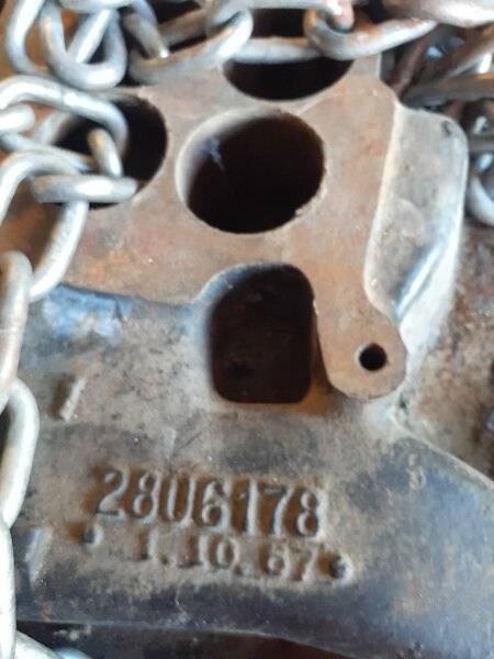

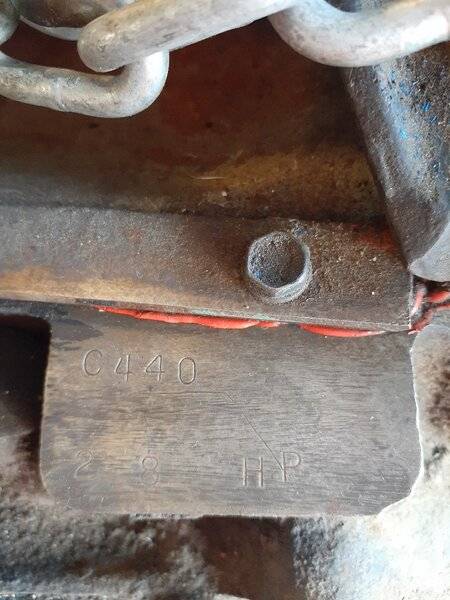

heres another option i have a set of 915,s on a 67 440 hp motor its a correct 67 block (10-67) with correct heads and intake is this is this worth more together or can i use the heads
I would guess that a block cast in 10/67 is a '68 motor. The 915's may not be original to that block or it's a low perf '68 motor. A 915, if it's the HP version(1.74 ex valve) would save you the trouble of up-sizing the ex valves.
your right i made a mistake with my fingers its 10-66 with a stamp on the pad of c440 hp

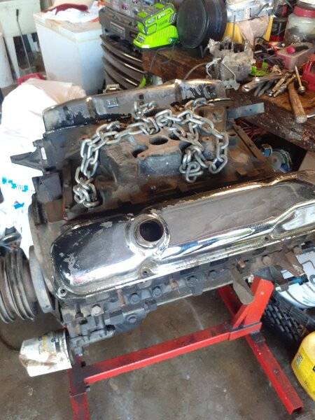

have a few pics looks like original chrome style valve covers
20200428_172419_resized_1.jpg 20200428_172410_resized_1.jpg 20200428_173844_resized_1.jpg
A numbers match '67 440 HP seems valuable. The 516's would work fine if you're not racing & looking for best ET.

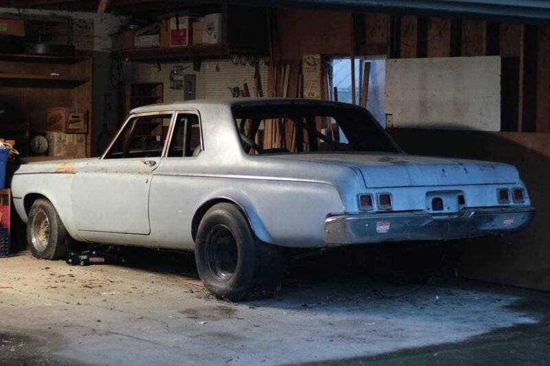

maybe a pass or two but mostly street use im pulling the 500 and putting into a 64 polara race car from back in the day trying to have fun and keep mopar history going
