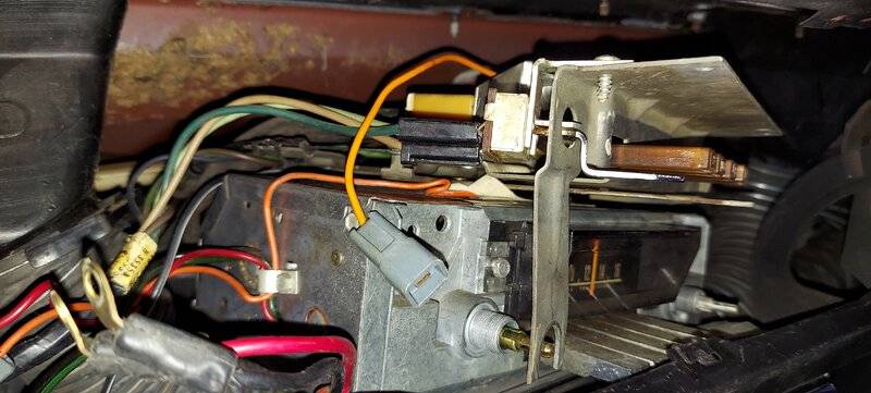

I'm putting my dash back together and am stumped. Where does the lamp on the controls plug into. It's a female single plug with a male spade inside.
Should be a corresponding connector and the other end goes directly to the fuse box.
Okay I tucked that one down the a pillar since it was off at that end. Thank you very much. I was pulling my hair out since nothing was right there.

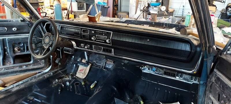

Back together.
For as much space that there is between the dash and firewall it is really filled up with stuff
