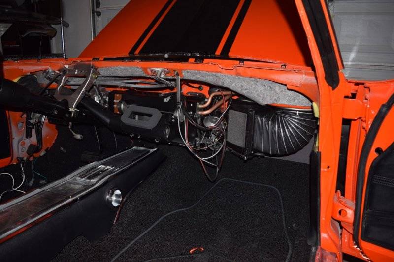

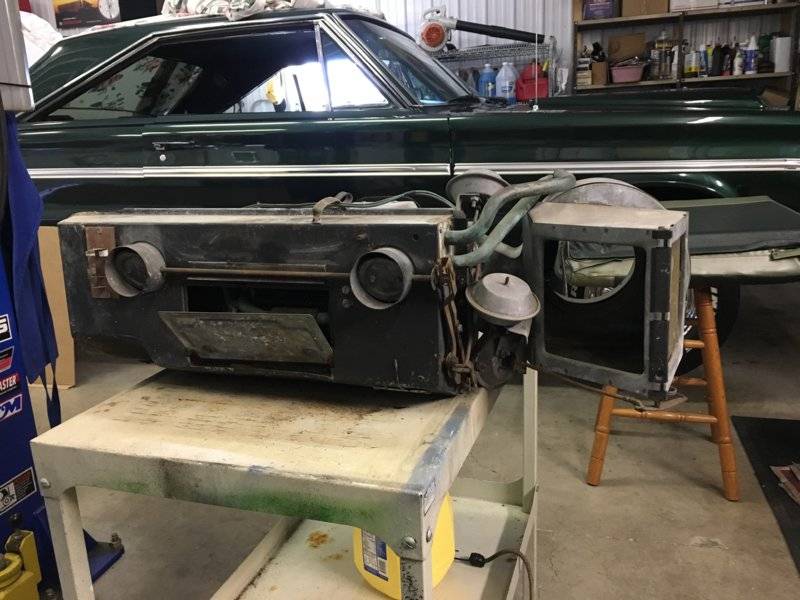

Ok,so what am I missing on the right side other than the blower motor?
CF4DAE5A-FB7B-47AD-837D-50ABE82FB0BA.jpeg F066E7C7-3DCB-4C35-B7C4-898FFB120521.jpeg
i believe just the duct work for fresh air that goes up to the cowl area.
Yes those ducts are not reproduced that I could find and worth their weight (and more) in gold.....
The other thing that is hard to find are the 2 "J" bolts that hold the duct to the cowl. My duct was ok but the "J" bolts where rusted out and snapped. I found a FBBO member that sold me a pair for a fair price vs the golden pair that were on eBay.
That’s insane! Just going to fab a drivers side for now. Thanks Mac
