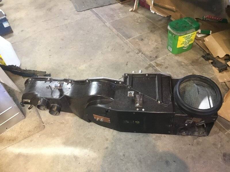

Heater box with mouse control. Hope picture come through or I will have to start pattern training again thanks to our son Charger Dana who was over tonight and had bubblies.
I did the same thing on both sides with 1/4" mesh stainless steel screen. And had to form the screen to a shallow hemisphere to clear the doors. Because I did find a couple of mummified pack rats when I disassembledthe car.
