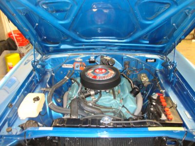

so i consult my Plymouth manual, and in 68, they are NOT crossed...whew!! i put them side by side so they look good.
and by no means am i a chebby guy...i dont have an ounce of chrome under MY hood!!! :icon_geek:
i know, i know, it's a 69 heater hose bracket...sue me!! it's still a part that's from Ma!!!
