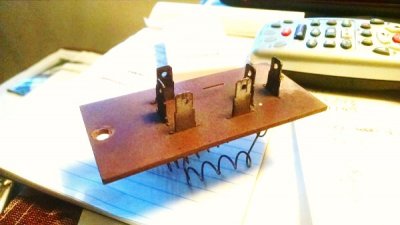

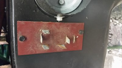

First, I think I missing a prong on my heater resistor that goes to my HVAC box, but I can't find a similar six prong heater resistor online so I'm not sure. Second, Does anybody have a wiring photo to the heater resistor. Trying to figure out the sequence of the four connectors. I know where the 3-prong connector goes but not the other three. This is for a 68 Charger. If in fact one prong is broke, I will need a new heater resistor.

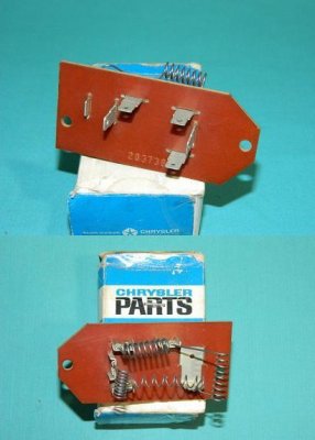

I believe the Mopar part number is 2837385 and was used on several Mopars with AC at that time. It doesn't appear the your tab is broken. It is common to the tab in front of it. I could only find a diagram for a 68 Plymouth with AC but if you look on page 2 you will see the colors match your wires. I think the individual dark blue & brown wire are for the time delay relay.

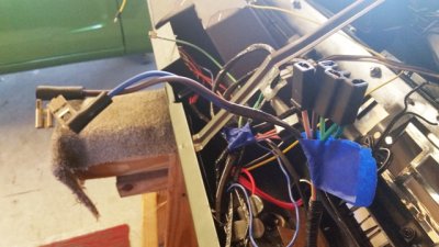

Thanks I just have to find where my Tan single wire goes.
his tab is broken off, I have 2 resistors here that have all the tabs still intact
Here's the thing..........the other three as you call them are electrically all the same one single terminal. That is where your tan goes
