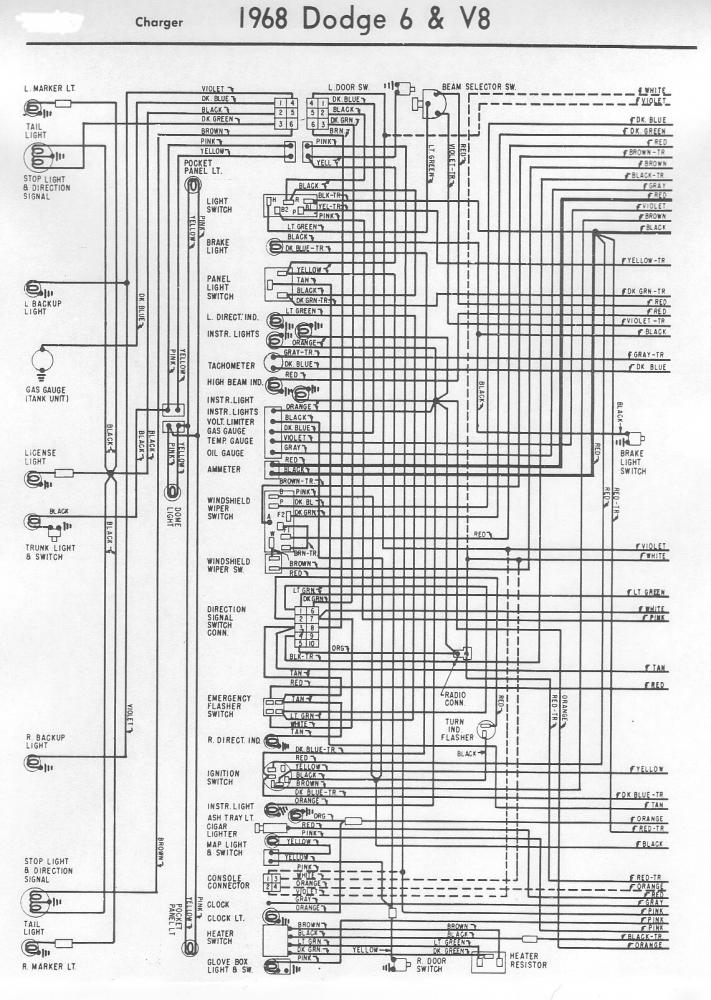

I am searching for the Heater Resistor that screw into the HVAC box. See picture below.
First off you should remove it and check the resistor loops for continuity to the male tabs. Here's a diagram of the wiring for you interior but I don't think you would have a five speed heater. Always use the color codes on the diagram to identify the wiring from the heater to the switch. Right click on the pic and save. Then open it in Paint or whatever to resize it. If you need the source it's:
http://www.mymopar.com/index.php?pid=27
I don't think the resistor is specific to your car, rather one with A/C around the same year.
