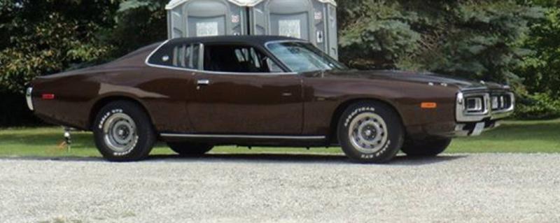

15x 8 rims in the back with stock backspace i run 275-60-15 tires i have 15x7 fronts with 225-70-15 tires fill the wells nice lots of room. i have stock springs and suspension. it was also a 318 car not anymore but nothing wrong with that at all! look in the resto threads to see the build if you like it may give you some idea's
Thx so much for the info! Much appreciated! She's beautiful by the way
