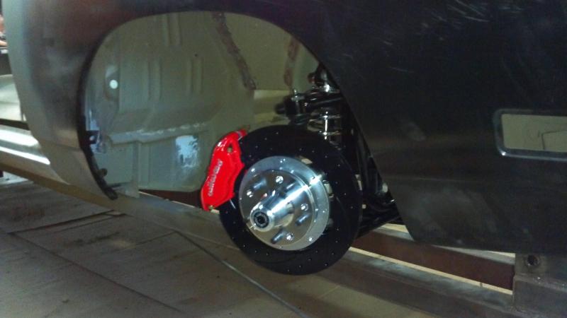

Front suspension pic
I know you guys like pictures, this is just a mock up to see how things fit, but here you go. If I post more pictures, where should I do it? Thanks for the warm welcome.

Welcome.and to your question.there should be a 68 to 70 B-Body picture section or one just for RR's..ok..Take care and God Bless..Bear R.-
