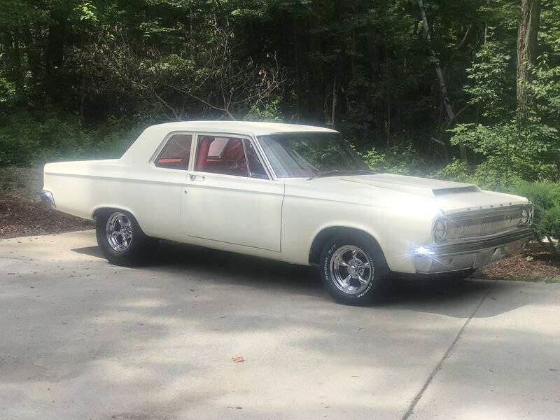

Working on a 65 coronet/426
Got a crosseam and 2 holleys
Dang thing runs rich but Im getting there
Any advice appreciated!

You might try lighter step up springs on the metering rods. At idle loosen the rod covers and see if they are up or down.
Then bigger rods on the larger diameter portion.
Finally smaller primary jets. All this assumes no vacuum leaks.
Good luck with it.
