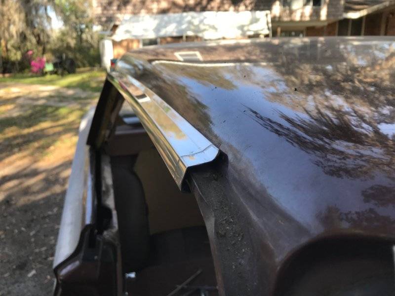

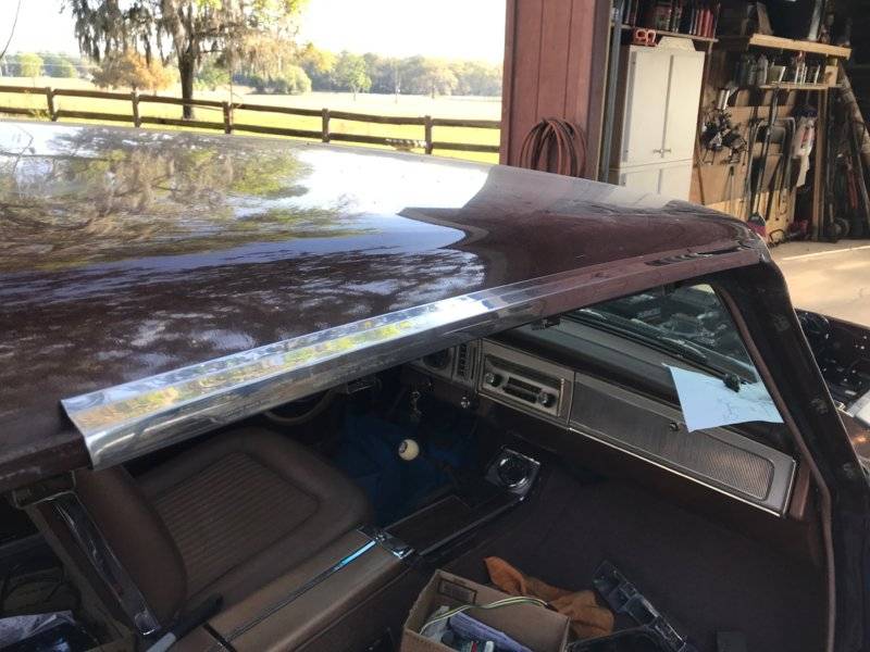

Here are the photos of the drip rail molding. Still haven't figured out the removal process. Earlier post said held on with clips....I only found one clip.

It's been too long, since I've done mine, so don't remember.
Are there any screws on the underside of them? Later today, I'll look at mine. If there's no screws, kinda recall they have to be gently pried out of place. Pretty sure, when going back on, had to force them into place.
Got a service manual? Might be something in there. It shows what takes clips, what doesn't.
There is usually two clips that hold them on. I used a thin metal putty knife from the top. Slide to find where they are located, and then mark. Take the knife and push down while prying gently. The clips are very, very hard to find that are not broken. Joe Shuchy has a newer style that are screwed to the roof if you break any. I will look to find mine, so I can post a picture of what they look like.

Thank you....found one of the clips. Will look again.

Still a little bugged about the 'clips'. Been too long, since I installed mine. With all the trim in place, impossible to see anything. Have a few spare pieces of the trim, in my open shed, so I'll look after it gets light.
Only thing I can really think of, regarding those clips, and the way that trim mounts...maybe what I call 'stands'. The top edge of the trim sports a narrow gap, to the roof itself, and those stands would force the trim off the roof, making that gap.
Besides kinda snapping into place, main thing that holds them on is the front/rear upper corner trim pieces, that fit over each end. He has them off.
