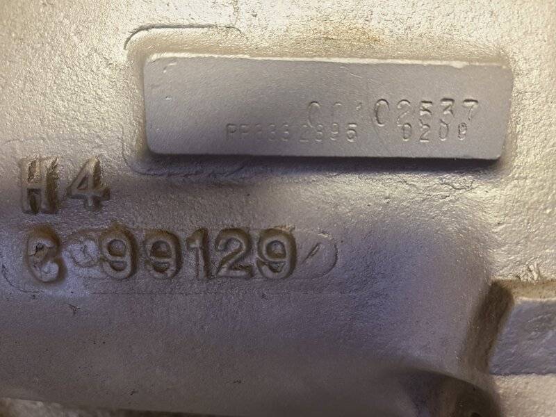

I would appreciate any info on decoding this trans. I have a 833 23 spline transmission. 99129 Case Date 2895 CC 02537 0209 308 bearings, 99621 tail housing B Body front mount(only) 2:47 Ratio..Thanks
Anything stamped in the raised pad on the right side?

Dipstick, here is how it is stamped CC 102537(may be OG/OC?) stamping is light on the right side, Below it and to the left PP833 2895 then 0209. Maybe the stamps weren't level when stamped. thanks for your help

it was built on July1 1969 ( 2895 ) early 1970 production carwhich your VIN code above tells you
Thanks for de-coding the date it was built. I thought it was Aug 1st 69. If possible, I would like to know what it came out of using the other #'s?
The vin code starting in 0 (1970) then a letter C or G tell you the plant, then vin sequence. The folks who track vin code can sometimes tell what cars were built on a plants numeric plan. A 308 bearing will mean it was a bigblock. All smallblocks came with the 307 bearing. (in 1970 )
