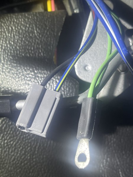

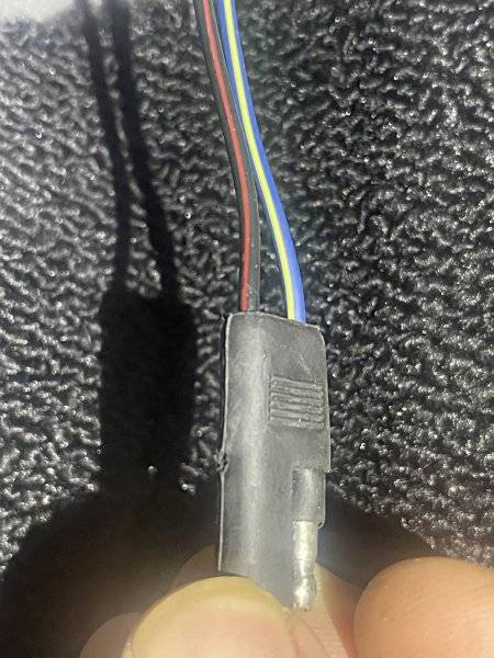

I have searched and can’t find what these wires go to.
1970 Road Runner new dash harness. I have a color wire diagram and the service manual but can’t find these anywhere.

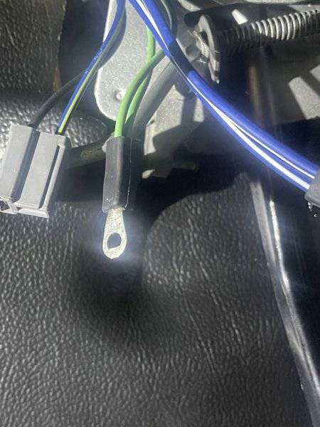

First is a blue with yellow tracer and black with red tracer. They have a separate connector and rubber grommet to go thru the firewall. The other end is at the left side of the dash. 9A97BBD0-ABDE-4193-A7F1-C62F002CADA3.jpeg

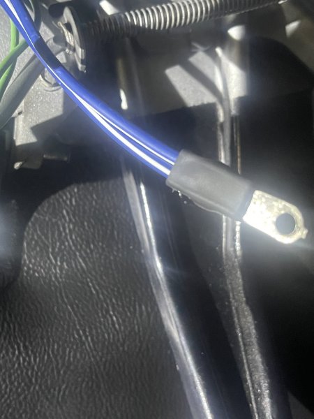

Also at the same location of the dash is a ring terminal with two blue with white tracers.

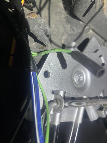

Ring terminal with two green wires. And two green wires in a female socket. 86C2B57C-9D32-4A1A-9964-BB65D9F77238.jpegB31AD983-E1C4-4D3C-9065-034D70DD7507.jpegF9A7D803-008E-40A7-AFB7-03476173BD4A.jpeg7EF0F9E6-E158-4A36-B96F-5F674F591A81.jpeg
Are these for power accessories like seats/windows? Any help would be appreciated.
Never seen those on my 70 but who knows. Thought fender turn signals at first for flat plug but hmmmmm

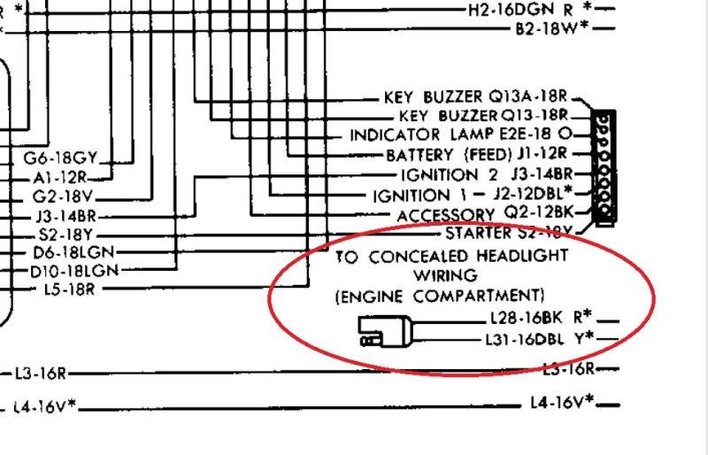

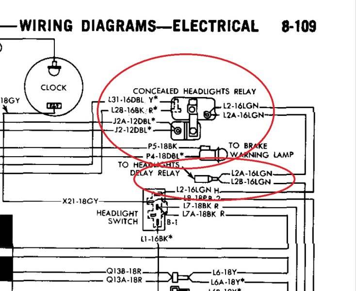

Concealed headlight relay for a Charger application. Pages 8-108/109 1970 Dodge FSM.
Be sure to insulate the ring terminals, heat shrink tubing, the dark blue wires are ignition1, they are live when the engine is running and not fuse protected.

If this is a new M&H harness it has extra wires for the 70 charger headlights.
That’s what I need. I got this car in boxes. Someone else had taken it apart and ordered lots of new parts. I don’t know who the harness came from as it was not in a package.
Thanks for the help.
