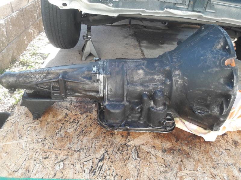

Help identifying 1996 3.9l ram van 1500 transmission
Is this a 42 re4 speed or a904 3spd

first pic is very good looks like a 904 variant

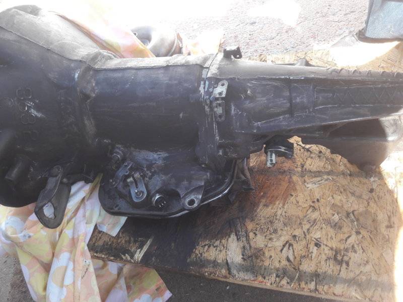

the second pic is too far away,get another one showing us the line/angle of the side.
i cant tell from here if its got the hump or flat but it looks flat.
hump is 727 flat is 904

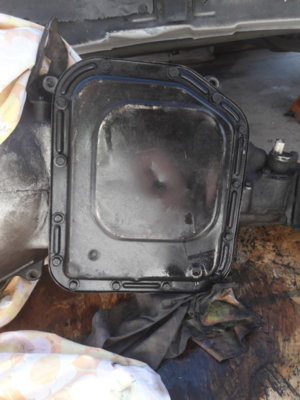

pan shape suggests 904 variant.
if this was an overdrive,it would be a variant of the A500
the 727 i think is the 518 variant.
hope any of this helps.
904 a500 if it was a 727 the pan would look different. However it can go by 42RH 42RE and since its pre 96 I believe it to be a 42RH. Later models would be a 42RE
RH is Hydraulic RE is electronically shifted with solenoids. RH is older like the 904.
Round connector with 3 pins neutral safety switch. The one towards the rear in the white round part is the speedometer. Those are the only ones I see. Where is the 3rd connector? Its a 42RH same trans I had in a dodge ram.
