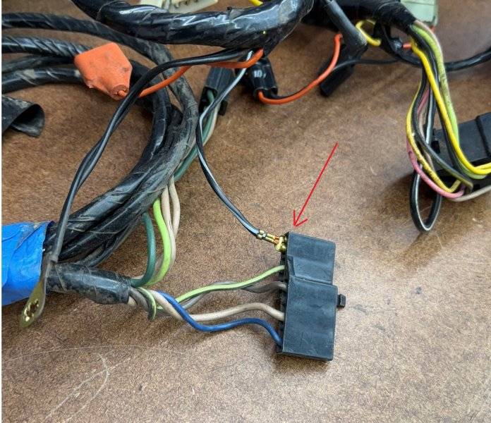

This one was a hard one to search the forums, so I am posting to see if anyone can help. I have a new dash wire harness from H&M and coming off the same group of wires going to the wiper switch connector I see this wire with the clip on it. It has power when touched by the light tester so it is live. I do not not think it goes to the A/c controller, but I did find this tab on top off the headlight switch, but not sure that would be for a wire with power.

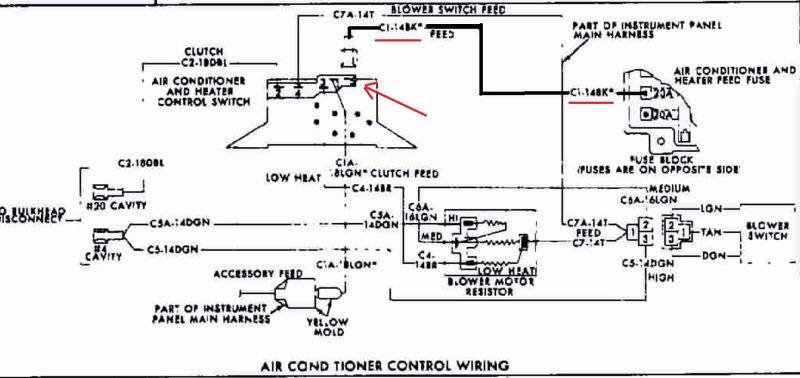

It should be long enough to reach the HVAC control. A/C and HEATER harness are not part of the main harness. That’s the wire to feed the control switch to feed the blower either A/C or HEATER car. It should be inserted into the corresponding switch plug.
It should be hot just with key in ACC or RUN.

The original A/C harness is linked to the underdash harness just at that wire to the A/C control plug, to the feed for accesories (to feed the clutch source) and from 71 to 73 with terminals to bulkhead to feed the clutch and blower (on 74 these get a grommet running throught the firewall out of the bulkhead), but still with those attached to the underdash harness is an independent one from the underdash harness itself.
When car is Heater (non A/C), the underdash harness remain the same but the Heater harness is linked just at bulkhead for blower and that same black wire to power up the system.
That’s the reason why A/C and Heater harnesses are not really part of underdash harness (same for both setups) as one piece, but just linked at certain points. This configuration allows to manufacture/sell/install same underdash harness for both kind of setups. Not just by actual manufacturers but also factory was like that.
So, you need to reuse your A/C harness, removing the terminals from locations mentioned and reinstalling the same ones on the new underdash harness. Still if being a NOS harness

Pretty sure it’s been identified as C1-14BK* (14 ga black with a white tracer), heater or A/C power lead. There is indeed an extra wire run needed to convert the dash harness to support a 2sp wiper to 3sp swap. Switch to bulkhead.

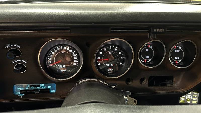

Yes correct on all fronts. I got a new headlight switch and did noticed that grounding tab was not on the old one, and while I was installing the DD cluster the wipers were coming on as I bumped the wiper switch into metal during install but did not come on once mounted. I painted the dash so there might too much paint to get a ground, but since the headlight switch and the wiper switch are attached to the same metal part of the DD cluster it is grounding once I added that ground wire to the headlight switch. I ran it to the same spot where the dash harness ground is attached.
How are you liking your DD? you have factory A/C?
let me look at my old dash harness, there was no clear spot to disconnect the A/C plug (harness) from the rest of the dash harness, but I could have missed it.
THIS.
This black wire comes from fuse box and is the power to feed blower
Plus the Acc feed to the corresponding rubber mold also coming from fuse box, which will feed the clutch function.
Plus the two wires to the bulkhead for blower and compressor clutch. On 71 both running to the NSS block, on 72 and 73 the blower to the NSS block and the Clutch to the engine harness block.
Those are the wires which links the A/C harness to the underdash harness
