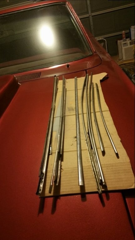

I just received the drip rail moldings I ordered from a member. The box looked a little beat up so I took pictures. The moldings inside look like they were stepped on or something. I notified the seller and sent him pictures. He said that they came off that way. I have my old ones and they didn't come off bowed. I hope someone can chime in and let me know if you think they are still usable. The ones I need are bent the most and I'm afraid to kink them if I try to straighten them out.
I didn't mention that the left 2 bundles are mine and the loose ones are the ones I recieved.
We restore a lot of stainless trim here in the shop, drip rails can be a challenge. Bowed like your's are is pretty common since most are taken off by just pulling instead of slowly unclipping. If they are not already kinked you should be able to slowly work the bow out. We have a simple die we clamp in a vise to do it. All it is is a chunk of 3/8 flat steel about 3" wide ground to fit the inside curve and smoothed (no sharp edges). The idea is to press slowly down with your hands the trim over the die working back and forth till it's straight again. the idea is you want to press on the center of the trim and not on the edges, press on the edges will almost always kink it. Hope this makes sense, I attached a simple sketch of it it works.
I removed those off the car. They have zero bends or kinks in them they are just bowed out. They need bowed back as stated above.

I remove a lot of drip rail molding. As said above it's not really an issue in my opinion.
The bows are common as no clips are holding them.When you push them on they will be held straight.
Having old trim straight is near impossible and why would you want it straight anyway?

Depending on which way they are bowed, you want them bowed to fit snug.

Wso8 after having a conversation with metalman I went out and tried to install the worst of the pieces. After some fighting and prying and minor chipping of my new paint I was able to get them on. I value the input and advice of the members here, thanks for your time. I dropped the dispute on paypal.
I am glad you got it figured out. I hate to say it but almost every car I have installed drip rail molding on needed a little touch up somewhere afterwards. Thank goodness for two-stage urethane paint.
