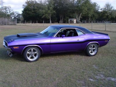

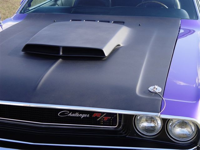

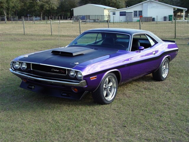

This is a Challenger I built for a friend several years ago. It has a Stroker 440 engine that was built by Herb McCandles. It is now 500 cubic inches and has Indy heads. It is backed by a 6 speed manual and a Dana with 3.54 gears.
The car doesn't really need 1st gear. It has tons of torque and is a blast to drive.
If it were me I'd go big.
This engine has a mild cam and makes right at 638 HP if memory serves me correctly.
It has power steering and AC too.
