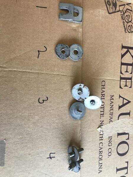

Help please identifying these.
BAFRAID
She’s looking like a Super Bee again!!
9:22 PM
Jul 18, 2016
806
1,099
Temecula, CA
Hey everyone, I am in the process of reassembly and identifying parts. I put everything into general bags but need a little help with some of these and some other miscellaneous stuff down the road. These all came out of my fender bag. I believe one and two are maybe shims but can’t identify three or four.
1) shims for fenders.

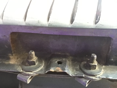

2) washers for shims that go at bottom rear of fender dog leg behind tire to shim them out from rocker panels. Two studs and nuts hold them on. They use round ones so they don’t fall out.

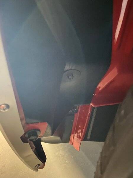

3) bolts to secure the tall fender splash shields behind the front tire.
4) studs and nuts that hold the fenders on. Top rear of engine compartment under the rear corner of the hood. He each side.
Nailed it.

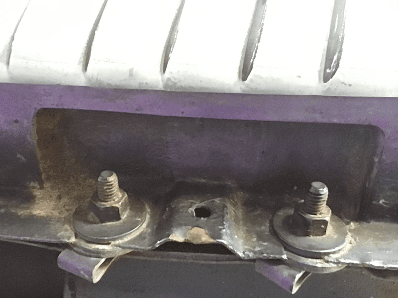

Here they are in place. Round spacers at bottom rear of fender.

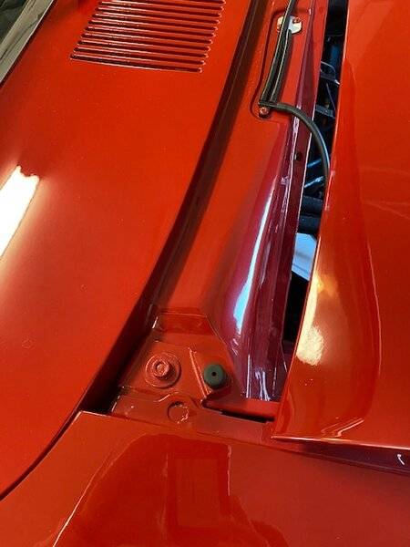

All of this is on a 66 Coronet 500. Upper left in Number 1. See between the fender and the Rad Support. Number 2 in Bottom Right and also what was just posted.

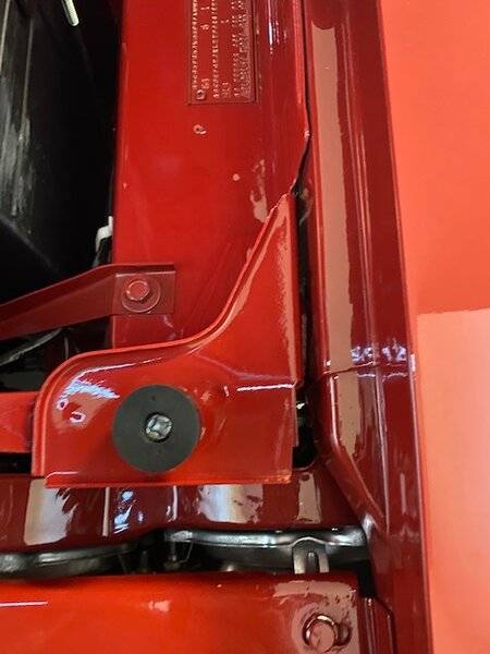

Number 3 is Bottom Left, just behind the front tire. Number 4 is Top right next to the Cowl. Best, B.
Oh, I used Bolts for the Bottom Right. My old ones were beyond restoration.
