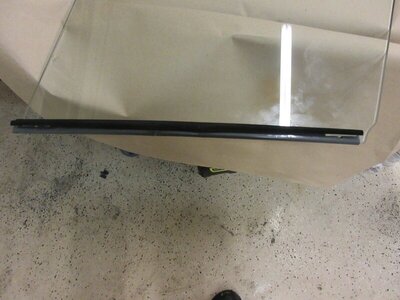

Since your glass seems to be out of the front track now, you may need to remove the plastic or metal glides that are pinned on, from it while still in the door, so the front will slide out in the front track. There isn’t a lot of excess opening in the window slot length for it to clear.

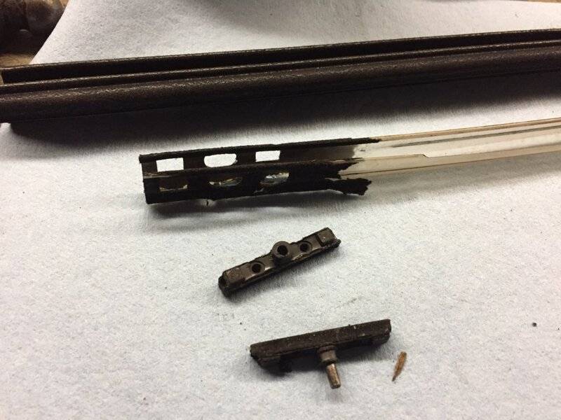

One thing to consider, however, is the plastic guide and clip. The last time I looked, the new guides and clips that are available have some fitment problems. They bind due to the fact they are not curved like the originals and the clips are larger than the originals. There may also be some trimming that needs to be done. There are threads about this. If your originals are in decent shape but the flocking is gone they can be re-flocked. Which is what I did to mine.

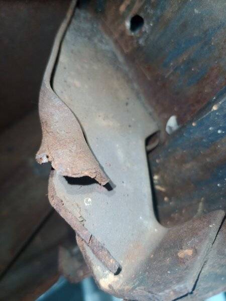

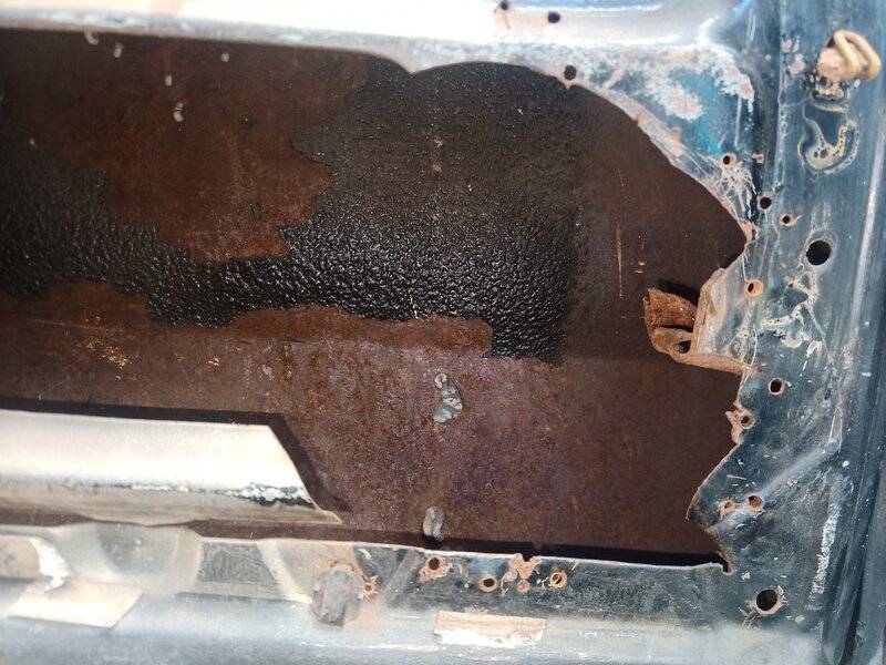

hello
i am in New zealand
i have a 67 coronet 500 convertible
someone put some front speakers in the door and made a mess.
i saw your post post on the window issue and noticed your door is in very good condition
if you still have you door apart i was wondering if you could please take some close up photos for me so i can reconstruct panel and brace inside door.
i will put post some pictures some pictures of my door so you can see the detail i need of a good door.
if your door is all back together dont pull it apart .
thank Will from nz

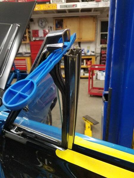

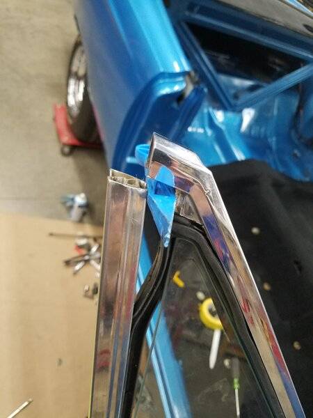

I just put my windows together this past weekend. The above replies are spot on. Here is how to pry the top of the vent wing channel open to slide the glass in.
