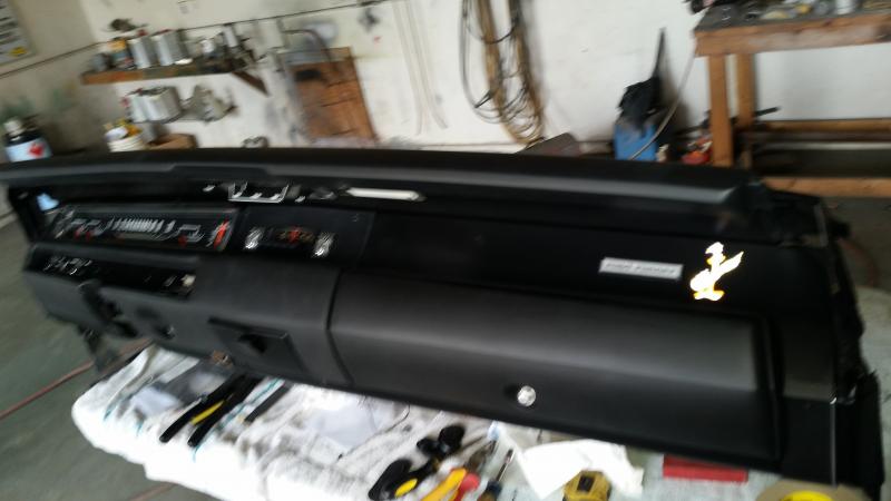

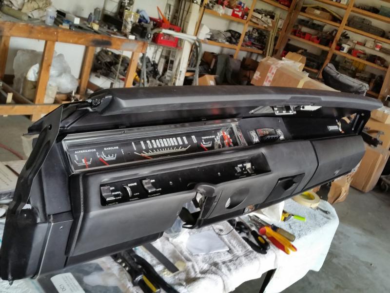

the entire metal frame is SEM hot rod black. it is a kit. I have done a couple of these and A body dashes and I believe its as close as possible without getting concourse correct. and its readily available.
I think its pretty close.
BTW, the switch panel is a different finish.

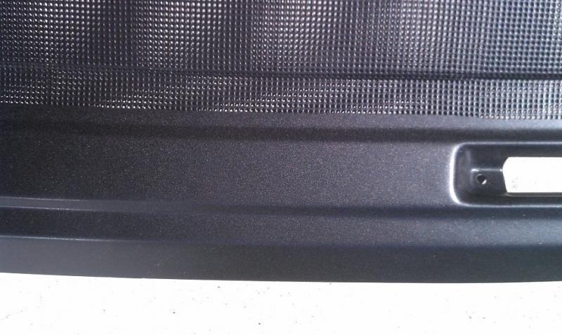

The proper paint is called suede and it does have a texture, but a very mild texture - not like wrinkle paint.
Just an FTI, the Suede Black paint is available here, http://www.instrument-specialties.com/products/manufacturers/chrysler/, its called, PPG Duracryl Suede Lacquer.
Here is what it looks like, it does have extremely small bit of silver metal flake in it, which is only noticeable when in bright light, and it does have a fine texture when sprayed properly.
