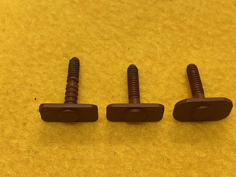

I got new hardware for the stainless trim on my 68 Charger grill. I don't have clear pictures of where the spring spacers go or the shorter studs go. I'd appreciate any help.
The 2 on the left are for the center horizontal pieces, the taller one on the left goes with the spring clips. The far right ones have a bigger base and are for the outer curved trim pieces.
The only way I could tell which took the spring clips was to look for the witness marks on the plastic.
