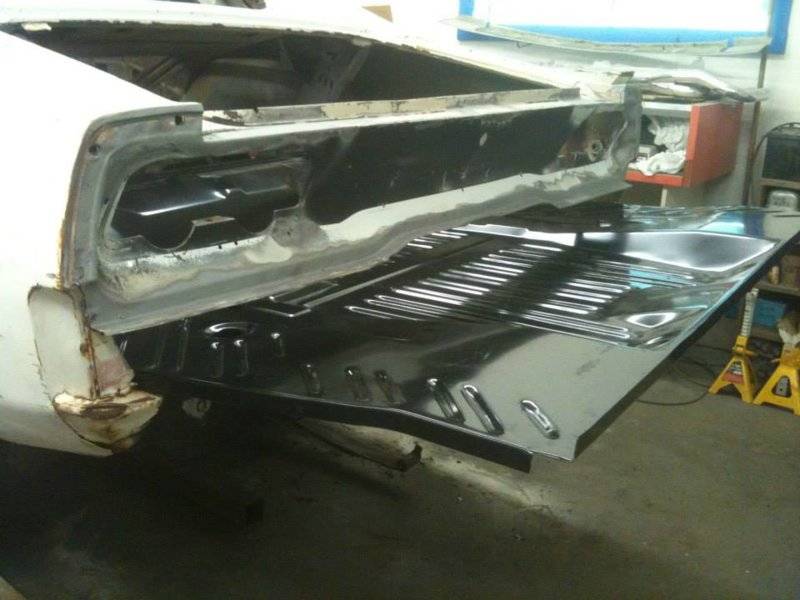

To install a one piece trunk floor, the rear valance needs to be removed. It welds to the rear lip of the trunk floor, so those welds need to be seperated anyway.
The new trunk floor will slide right in from the rear with the valance removed.

Unless you buy a sub par floor lol. Mine was a 2 piece and stopped 3/4" shy of the rear. Ticked me off because that lip was rotted too, had to fab an extension to the new floor! That was before AMD offered the nice ones.

Yes, The AMD pans are the best. I would recommend the one piece pan though.
The rear valance welds to the trunk floor lip. and to the tail light panel, and a few spots at each end. Unless you are really trying to avoid any exterior painting, I would suggest putting in the one piece floor. The rear valance can be removed and reinstalled. Here is one I did. The rear valance was junk, so it had to be replaced anyway. The new AMD trunk floor slid right in
