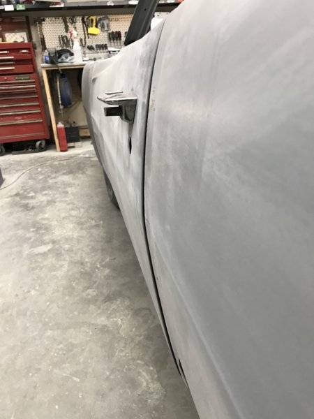

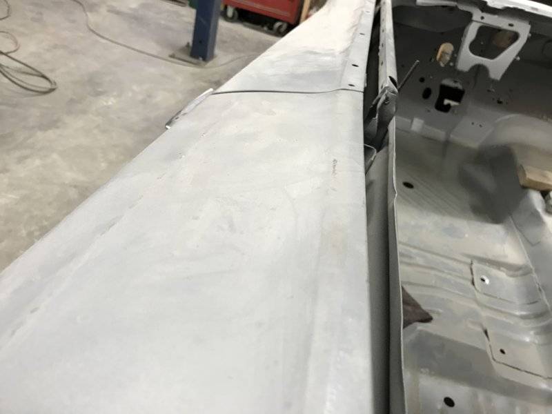

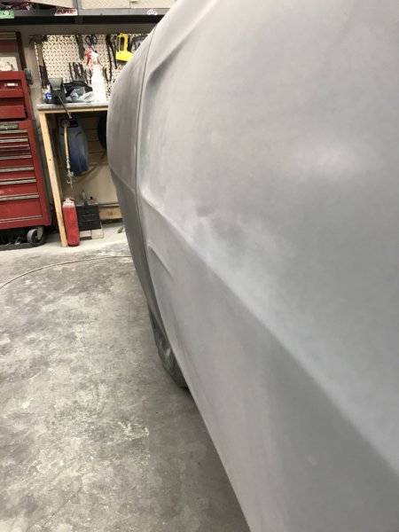

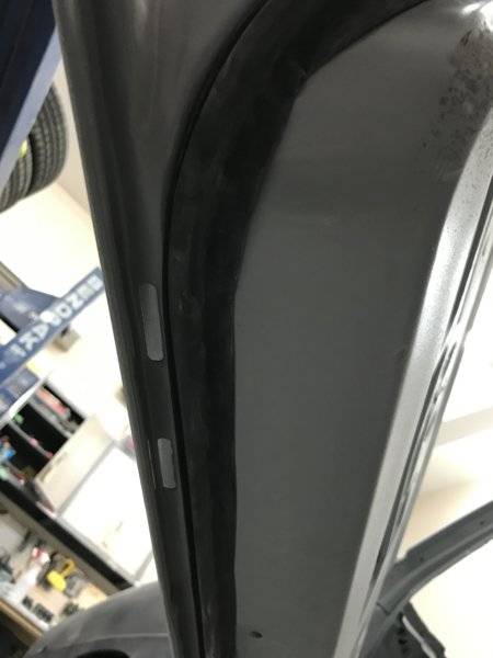

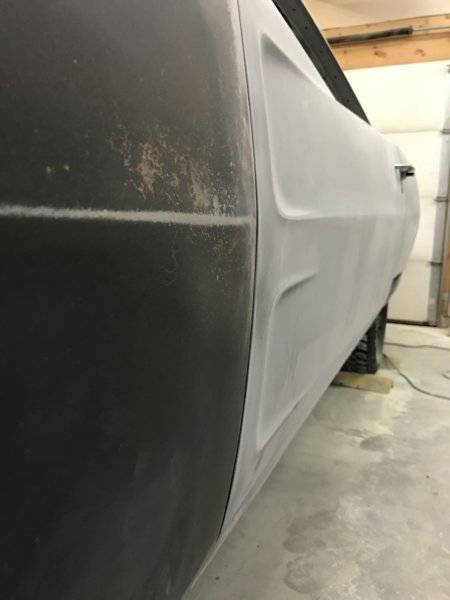

hi folks, I would like your thoughts here. I installed the drivers door and fender to do my initial gap and panel alignment as part of this restoration and had all the lines and gaps set to near perfect. I then installed the door latch/handle and a new door seal, from soft seal. Now, because of the seal, the door is being pushed out at the bottom and causing the door to get out of alignment. See the photos. I believe the seal is installed correctly, but you can comment on that too based on the photo. Maybe this is a know issue with a brand new seal, or with these seals in particular. When I push on the bottom of the door to see if I can bring it back into alignment, it’s very tight and takes a lot of force to squish the seal enough for the door to get back into alignment.

Top of the door is still lined up-
Front edge is fine
I am having a similar issue with mine once I installed the seals and latches. From what I have read its damn near impossible to get a perfect alignment on these with factory latches. I messed with mine for over an hour re positioning the latch assembly until I got it to what was acceptable to me but it still is off slightly in the lower part of the door. Maybe as the seal breaks in it will improve.
The repo seals are stiff and cause this problem.
Ugh. I’d hate to modify the quarter edge (cut and extend outward) to get this into alignment but I don’t want this look either. What to do.....
It is due to the harder, newer seal....it needs a lot of usage to relax and conform.....
The best route is to buy a good used OE seal. Good ones are still available and they can be cleaned up....you can buy the clips separately...

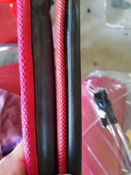

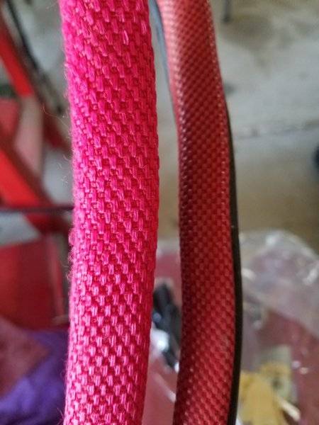

Yes the supplier had sent me a 2nd set of seals as a check of some possible production flaw and there was no difference. He said the seals come from one supplier (that's what he thought) and basically SOL. It was a stretch to put these in thinking they would conform somehow and exacerbated by my seals fitting beneath the door sill plate. He had said maybe the black lattice seal was smaller though after months getting my car back together I salvaged my old ones until such time might find seals that fit.
Here's another photo showing difference; I had spec'd them sending this to the supplier (don't have that info handy here) and the sizing was ridiculously larger wondering how the mfg would sell these...with today's mfg capability they couldn't produce a seal matching what was made 50+ years ago...go figure.
I just installed a set with zero issues...... I do it AFTER the striker is set with the 2 little bumpers installed......... I still have the packaging, probably in the trash; if I find it I will post it
during mock up I dont even use the latches, let alone the seals....... the sheet metal should fit on it's own
try adjusting the top of the door out to match the bottom.... then adjust the striker to close tighter
