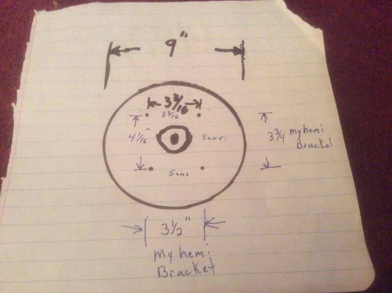

I have a 318 1969 charger which i made into a 426 hemi charger. I got the hemi power booster bracket but cannot get a booster. Dr. Diff told me to call Booster Dewey which i did, he retired and son won't help they quit doing it. Does anybody know how i can make this 426 hemi brake system work? Is there anything or anybody that can help. If not we won't be able to put an old hemi in any mopar again with power brakes. Even if i find a correct booster there is nobody left to restore it to woking condition. Really need help!!

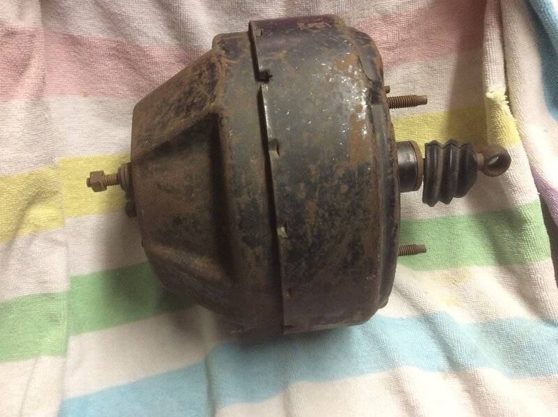

If you got a bendix booter (non- Hemi) you could reposition the mounting studs then sent it out to be rebuilt or do it yourself. Have non-Hemi booster.
