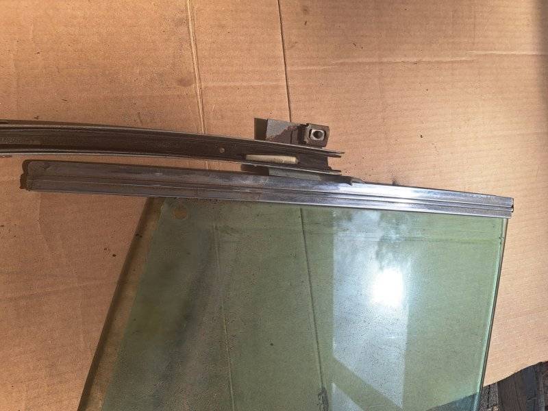

Vent window and all window hardware is in and noticed the upper stop will that not allow me to side window down in channel. So do I unhook back channel and lower window in then hook channel back up? Will that work? Had to replace window channel felt thats why it apart from vent window.
Look through my 70 thread Dave.. the 7UP machine. Did those doors as well, I don't have time tonight with a car show in the AM here.
That's exactly how I did mine. Unhooked the back channel, lowered window in as an assembly with vent wing and hooked it back up. So much easier.
