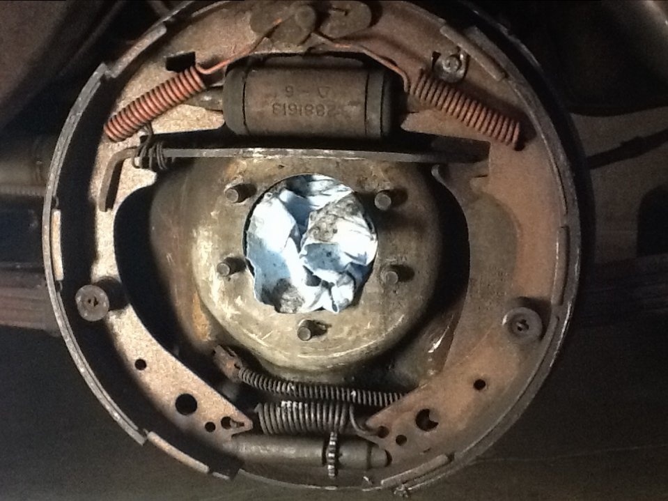

ive got a 69 rr with rear 11" drums. They do not have the self adjusting cable setup. I have not had any luck finding a drum hardware kit for these manual adjusting drums specifically the lower spring. I did get a drum hardware kit that looks like it has the same upper springs along with some that do not match any springs on my setup and no springs that match the lower spring. Hard to believe I can't seem to find a hardware kit for these. Any help is appreciated.
I helped a buddy do his brakes over the winter on his 68 runner, and he went with the 1970 hardware with auto adjusters. Readily available.
If you haven't fixed or changed it -- I have the CORRECT adjuster kits with cables for 1968 & earlier -- they are different........
Can you set me up with kits F&R 11inch drums on my 68R/R ??

Look on mid 80's trucks.
I have an 87 D150 with an 8 1/4 axle that has 11" drums.
