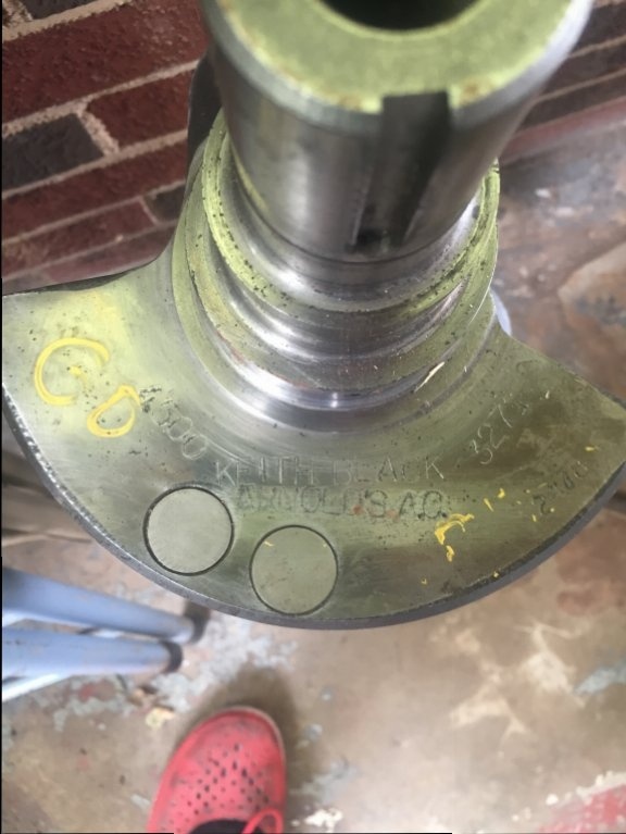

i have 2 4.500" hemi cranks. 1 is made by Keith Black the other by Sonny Bryant...I had both magnafluxed and they came back good. What would they be worth, can anyone tell me or just give me some insight on them? Thanks
Judging by the keyway, it's a fuel crank. The four slugs of Mallory metal are worth more than the crank.
But it would work in an after market block, like a world block?
No. Look at the back flange and see if it has a flywheel/converter locating hub in the center. Most do not. The cost for all that work exceeds the cost of a new ready to run crank. Besides, they're usually so full of cracks it's not worth jepordizing the rest of the build to run it.
He said he had them both magnafluxed and they came out good.....
Take a pic of the flange and post it or you can tell us if it has the FW or converter locating hub.
