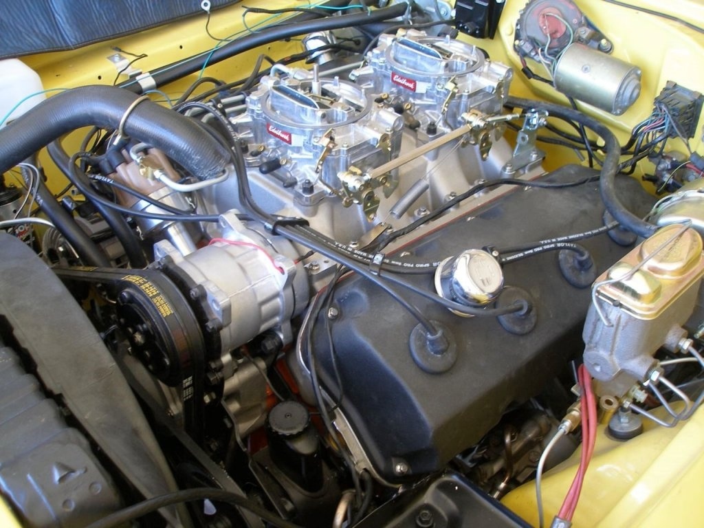

I have the Hansen Stage Vs on my 1970 Hemi
If I were doing it all over, I would go with Mother Mopar's heads
Just saying
That is interesting, as their website gives the big build-up of how much better the Stage V are than Ma Mopar offerings. :rolleyes:
I still have the HotRod magazine somewhere from when the Stage V were first advertised.
Yes, I bought mine in 2003?
I believe the Stage V's are perhaps more suited to "Racing"
Which, in itself is A-OK
However for my 70 Superbee, being am original 383 A/C car,, when I ordered my AC kit from Bouchillion (JBP) I found out that I had to engineer/modify a bracket.
Reason being:
Unlike mother Mopar's Hemi heads, the Hansen Stage V's are missing a machined hole on the end of the head.
This bolt hole is missing, and it is important if you wish to add the Sanden style AC compressor.
Again, I had to modify a bracket.
(Came out okay, but it was a bit time consuming)

Hemi with A/C
So:
K-arms,
A few interesting notes on the Hansen Stage V heads
1. They are NOT cheap
2. The Stage Vs require you to use the Hansen Manifold
3. The Hansen Manifold spacing between the carbs is NOT the same as Mother Mopar
4. IF you decide to "RUN" the Hemi style oval air cleaner set-up like I have, you need to purchase the set-up exclusively from "FHO" (For Hemis Only) Tim Banning.
(Tim Banning, a great guy and extremely knowledgeable on the Hemi)
5. I was running the unique Holley "Short Bowl" set-up and in fact that is what I used on my Dyno run
6. But: with the Dual Holley "Short Bowl" set-up, you have to run a different style "Air Cleaner" set-up, like 2 individual 4" round ones
