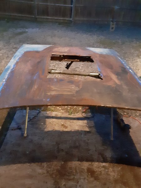

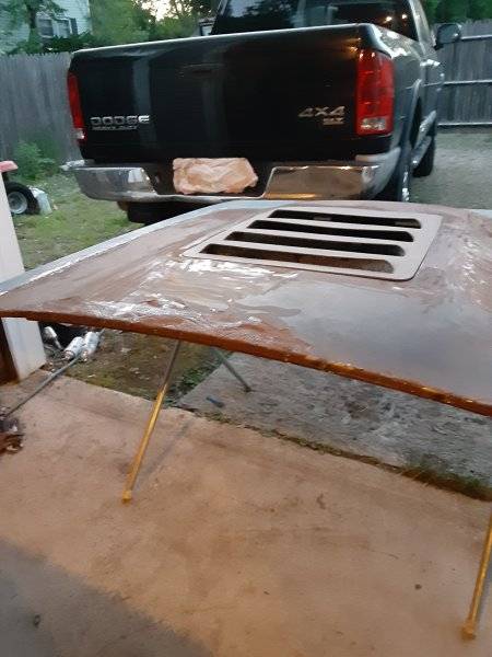

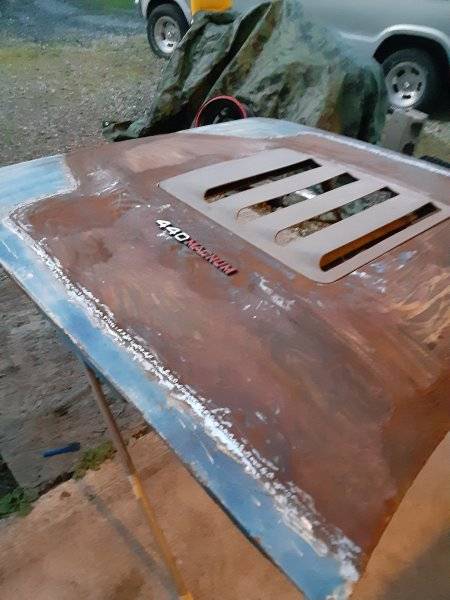

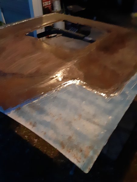

This is how I fixed the Hemi hood clearance issue on my 70 Charger R/T.
