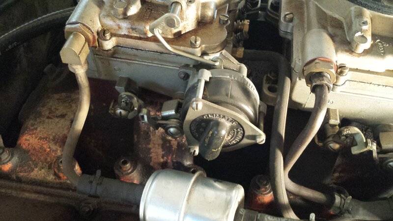

Fran, not my car but
if you can zoom in on this front carb, both of mine have the front, right vacuum port pugged by a bolt. Guess I need to remove a bolt and see if I can find a threaded port that fits

Mine is coming off the primary (rear) carb on the passenger side.
Edit: I found a good pic.
Any chance you have a picture of it? Does the nipple look pressed in, or threaded in?

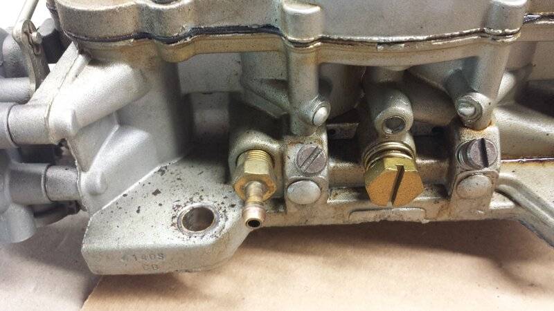

Here's a pic of it on the bench while I was rebuilding them. It's threaded.
If i had to guess,,
I would say 1/8" NPT
That’s what I’m thinking too. Looks like Summit has it.
