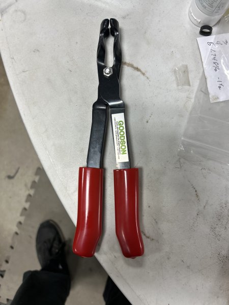

Question, is there such a thing as a Hemi spark plug tube puller? Barton valve covers and stock tube and o-rings, Edelbrock heads with o-rings. I used silicone grease on the o-rings, sorta had to drive them in. Now difficult to remove.
Do the heads themselves have O-ring grooves built into them or do you have the (blue anodized) Milodon plug tube inserts?
The Edelbrock heads that I have , the groove is machined into the tube bore. Seems like 53 years ago when I helped on a Hemi Cuda race car, there were maybe different o-rings? Long time ago.
