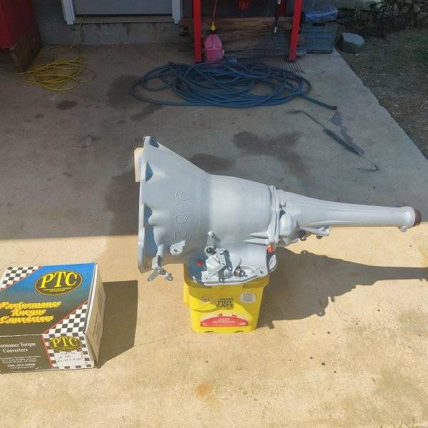

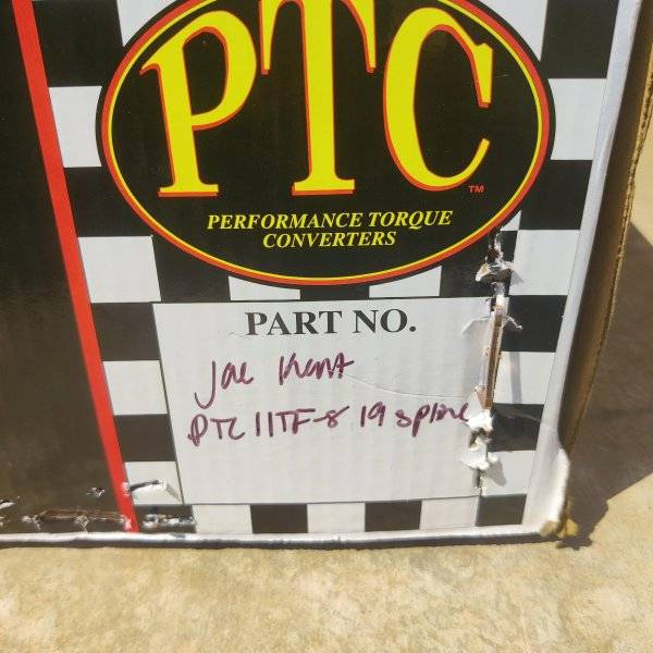

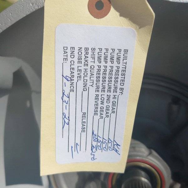

Dropped it off 10 months ago and got it back yesterday. The transmission was pretty rough inside and had several parts seized up and pitted. Pretty much everything inside the transmission had to be replaced. but they were able to save the case for me. I told them, I really wanted to keep the original transmission to the car. New torque converter to match.
Big thanks to PTC for the help.
New torque cView attachment 1347642onverter View attachment 1347641to match. View attachment 1347639
