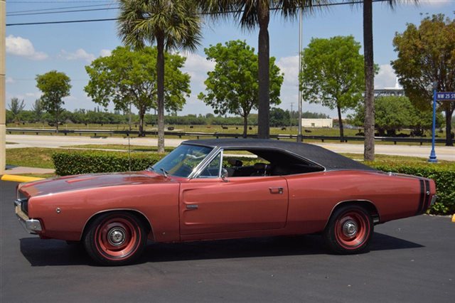

REAL DEAL 1968 CHARGER R/T HEMI INSPECTED BY DAVID WISE.
1 OF ONLY 467 DODGE CHARGER RT HEMI'S BUILT FOR 1968
1 OF ONLY 211 OF THOSE WITH 4-SPEED TRANSMISSION
STILL RETAINS ITS FACTORY BROADCAST SHEET
THIS CAR WAS TREATED TO A DOCUMENTED FULL FRAME OFF ROTISSERIE RESTORATION AND FINISHED IN ITS ORIGINAL COLOR COMBINATION OF BRONZE POLY WITH BLACK VINYL TOP OVER BLACK BUCKET SEAT INTERIOR, DURING THE RESTORATION A PISTOL GRIP SHIFTER WAS ADDED BUT CAN BE EASILY CHANGED BACK TO CORRECT INLAND SHIFTER. THIS CHARGER IS LASER STRAIGHT, HAS EXCELLENT PANEL GAPS AND FLAWLESS PAINT WORK. NOTED BY DAVID WISE (RENOWNED MOPAR EXPERT) DURING HIS INSPECTION THIS CHARGER:
IS A FACTORY 4-SPEED HEMI CAR
HAS ITS ORIGINAL VIN PLATE AND TRIM TAG
THE UPPER RADIATOR CORE SUPPORT HAS THE CORRECT MARKINGS
THE DECK LID SEAL STILL HAS ITS CORRECT MARKINGS
CORRECT TORQUE BOXES AND REAR FRAME TIE PLATES
CORRECT 780 AND 781 TORSION BARS
ORIGINAL FRAME AND FLOOR SHEET METAL
CORRECT SKID PLATE AND ANTI SWAY BAR
MORE INFO, RESTORATION PHOTOS AND FULL WISE VEHICLE REPORT AVAILABLE UPON REQUEST
THE RARITY AND COLLECTABILITY OF THIS 1968 DODGE CHARGER RT MAKES IT AN EXCELLENT INVESTMENT, THESE HEMI POWERED CHARGERS ARE ONE OF THE MOST SOUGHT AFTER MUSCLE CARS ON THE PLANET!
PLEASE CONTACT: HENRY FERNANDEZ.

Not a bad looking car at first glance, but there is soooo much wrong with that car. If you are going to ask the big bucks, one should not be able to nitpick. Just quickly looking through the pictures you can see....
Wrong shifter lever, not painted on the sides of the radiator, painted wiper motor, painted heater box attaching nuts, door panels with no map pockets, wrong grain on vinyl roof, unpainted door attaching bolts, air cleaner on backwards, no PCV valve, defroster hose hanging down, engine wiring wrong, no vacuum headlight hoses (how do they open????), washer hose routed wrong, wrong RH valve cover, wrong distributor and cap, no resonators, exhaust hangers next to the gas tank???, wrong master cylinder, painted hood latch, no public law decal in driver's door,not original color, etc, etc, etc.
Inspected by David Wise...whoever he is. He'd have been better off having Richard Cranium inspect it! But if I can pick that much apart in pictures, one can only imagine what one will find in person.

It really is interesting to watch the educated eye critique a restored car. I only noticed a few of those things, and wasn't absolutely sure of those. Quite informative. Thanks RC !
There is a big difference between rebuilding a car and restoring a car and everyone's version of "restored" is different. It's easy to critique someone else's car, but it's a pet peeve of mine to see cars with so much that is incorrect being touted as restored.
