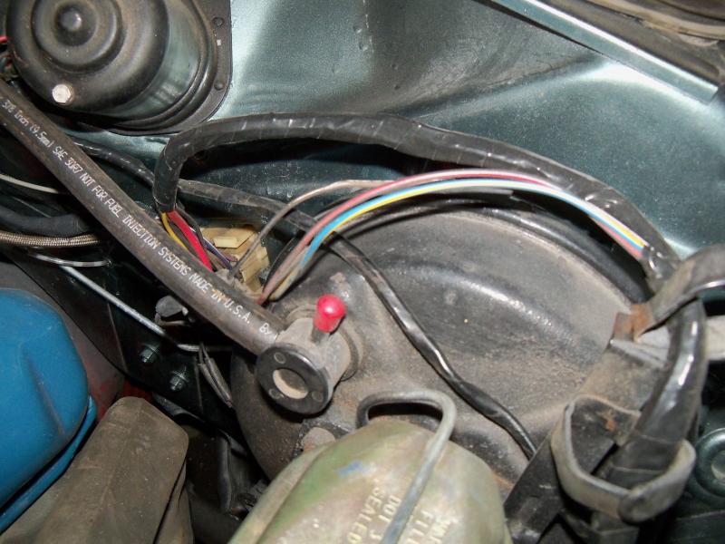

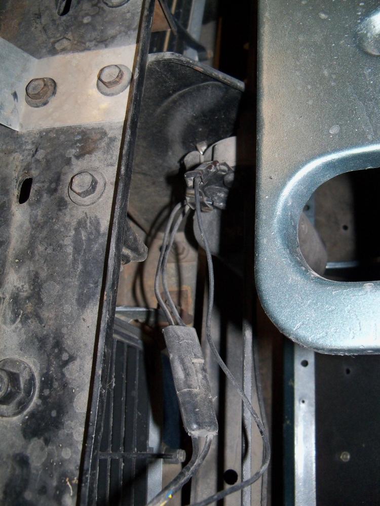

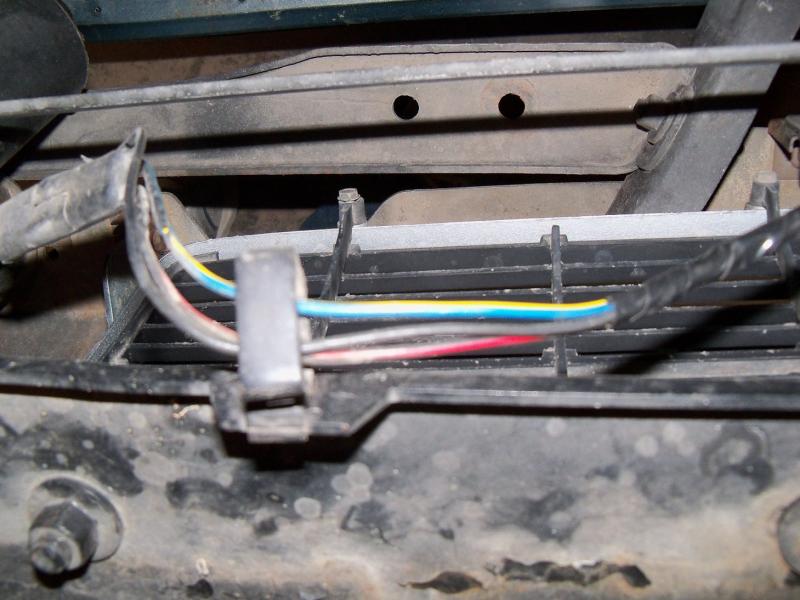

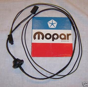

attached you will see pictures of my wiring harness. as far as where it leads, man I cannot find my 71 wiring schematic to get you on the interior.. I am sure someone has it somewhere.
