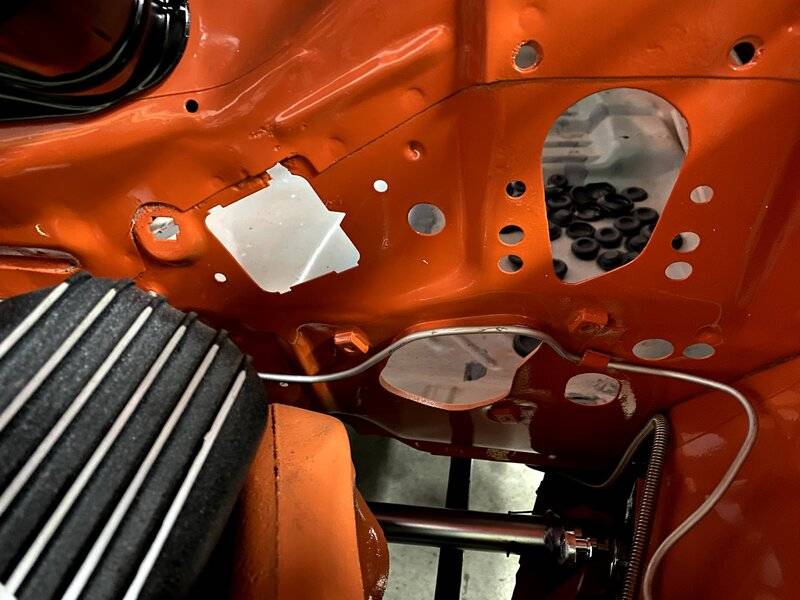

My 71 Bee did not come with hideaways however I got everything I need. What I don't know is where the hole in firewall is to run the harness from the relay back of the dash to the headlight motor. Anyone got a picture?
Thx!
Nuke
Its the 3/4" hole directly between the bulkhead connector and master cylinder, you should have have a dimple there.
