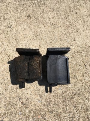

I've been chasing a high speed vibration--it starts about 60 mph and stays there up to 80 mph. If you throw it in neutral at that speed, the vibration stays. New tires, all balanced, rebuilt front end and aligned. Transmission mount was toast and has been replaced. Vibration remains.

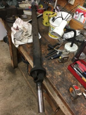

I pulled the drive shaft and inspected it. Shaft looks good. Both U-joints are good.

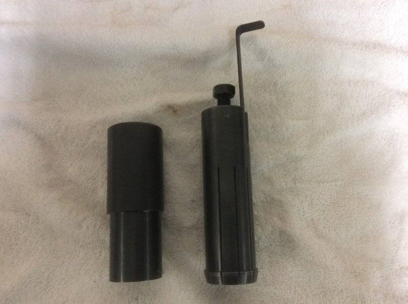

Here's the tool for a 727 or a manual trans. Don't think fits a 904 trans

I would consider renting the tool if you do change the bushing. $130 in P/P will Return $100 if you return tool in good condition.

Is that tool required if I remove the extension housing on the car?
Probably not. When I pulled mine it made a pretty good bang when it came loose. If you remove tail shaft housing a trans shop could do it cheap. They wanted $90 to do mine but I have a H-pipe and it would be hot when got there. Its tight and wasn't sure if they could do it without dropping the pipe.
