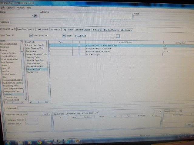

My old book and my computer basically give the same info. Its broken down by pump type not pump brand. One of the IC numbers was switched at one time. Pumps are not listed by motors size, but if you read the interchange it does list a number you should be able to reference.
