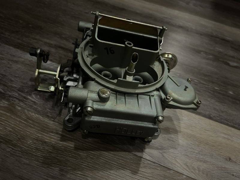

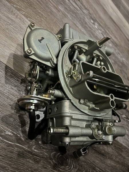

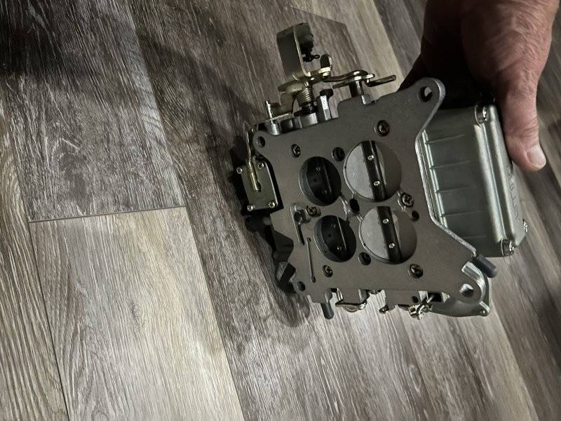

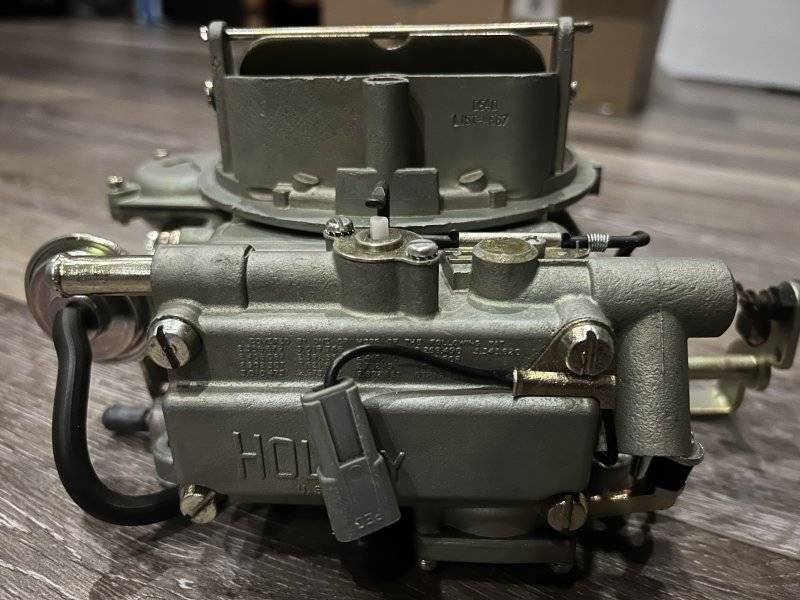

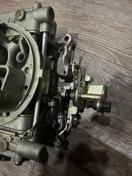

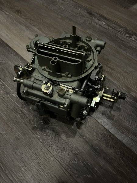

For the non-believers. Restored by Harms Auto.
