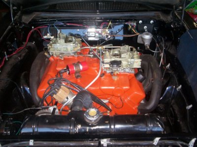

this car has a mw packaged 440 bottom end , pump gas engine . we run twin 660 holleys on it from street to track . drives like a hotrod car , no fouled plugs . but fresh plugs are a wake up .
What fuel lines did you use or did you make your own? Pictures would be helpful....thanks
sorry no pics on hand . did a custom set from the 1/2 feed line to the holley fuel reg on the fender well with two 3/8's fuel lines to the carbs . throttle linkage was done like a stock setup with a idle solenoid for running idle . that drop off with the key off for engine shout down . mounted on the manifold , so it pushes on the bell crank of the throttle linkage .

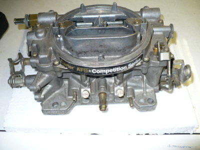

I've used 600, 750 Eddy's, or stock 3447, 3705 Carter's. Any will work fine.

How/where did you mount the throttle return springs
we built a bracket from the front left carb to the pivit arm of the linkage and as for the throttle arm hitting the manifold we just cut off the small portion that would have been on a chevy return spring
