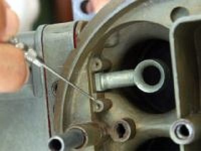

It's not going to make a diffecence whether the pcv is attached to the carburetor base or the intake. They are both the same vacuum source. Oil will not make it run rich anyway, it will simply smoke. Plus, as long as the pcv valve is properly baffled at the valve cover, you'll not get any oil in the pcv system. Let me ask you this. Have you tried running some thin wire down all of the carburetor air bleeds? If they get stopped up that can certainly cause the condition you describe. Look at the picture. That's the air bleeds. There are four in the rear and four in the front. They need to be clean and unobstructed.

I have not tried that but I will for sure that seams easy enough to do. You dont think that the engine acting like it has a vacumn leak being that the manifold is constantly drawing air from the valve covers. I think you are right on the rich part but what if the PCV is confusing the idle circuit. I think the smoke may be oil though. I dont think the PCV is suposed to have full time manifold vacumn. I cant wait all day at work I want to get home and try this. It just has to be something dumb.
