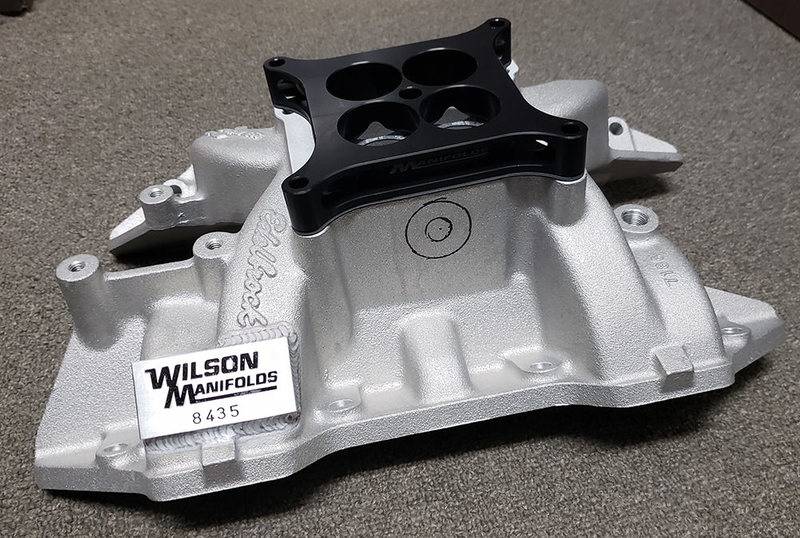

I'll be using an RPM Performer dual plane ported by Wilson manifold with a 1" tapered spacer.
Going by what I've read on the Sniper forums this setup should work with the EFI and my 383 motor combo.
