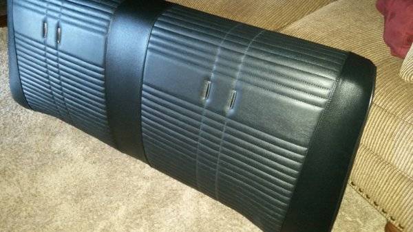

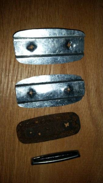

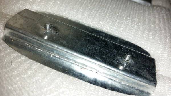

Finally found 4 more seat medallions for my 68 RR. One backing plate missing, 2 rusted pretty bad, so I made my own out of a piece of flat galvanized duct work. Bent them up in the vise, drilled holes and used sharp thin chisel to create the tabs. Snapped right on and seated tabs with a small socket and a tap with a hammer. Emblems are recessed just like factory.
View attachment 560725 View attachment 560731 View attachment 560732
I love fabricating little stuff like this. So many people don't even think about doing this. :) thumbs up bud!
Good work....If you did the upper seat cover replacement yourself...Very nice job!
